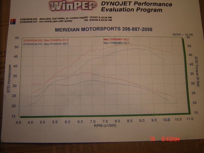

So this graph shows ron woods pipe, big [email protected] filter, pc tuned vs. same mods with web(dasa) mid cams and cp 13.6 tuned on sunoco110. We were disappointed none the less. We were told we wouldnt get more than 50whp by more than one builder. I guess they were right.
For comparison only. 3mod 08 ds vs. 3mod 08ltr450

Im not sure the guys isnt to happy. He is a bigger guy(245) and he is wanting more torque. Im not sure what he wants to do. He might order a rossier intake setup to try. Just gonna try something different I guess. He would have to spend $1000-$1250 to get a decent port job. Unfortunate it costs so much to do the heads. Even mild port will cost him $500-$750. So I think he is tossed. Bike runs well just not what he was hoping for. We did a little pull down the street last night against my stock ktm505 and I pulled him pretty easily. Sooo I dont know??

im still blown away how much hp gain the ron woods kit makes. with the exhaust cam and his kit....hot damn...i dont see why you guys could want more power lol
