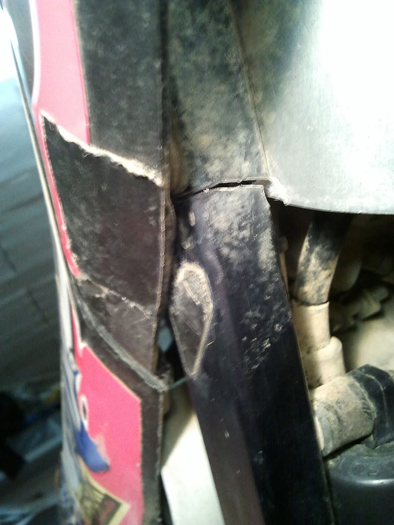

Hello,
Bad news, i've noticed my support engines mount are broken again... but then i saw my upper rails frame are broken too!!! both sides -->
Anyone else? or i'm the first one?
Can I weld putting a plate to reinforce?
I've the the part numbers, right, left
705 201 057
705 201 056
Thank you

I have seen the engine mount break before, but not that part. Have you recently removed/ replaced the engine backet and possibly overtightened it when you put it back together? Any broken frame sucks :-(

I will put silent blocks or rubber in the engine mounts this time for sure!
Yes, few months ago my dealer changed the engine mounts, but this long bolt has two spacers preventing overtighten?¿ I don't know.
Yes, lot of jumping... but it's so funny xD
This sunday i have a race, so i will weld and reinforce.
Don't worry about your ds, this weekend i saw also a subframe of an yfzr also broken
1,180 Posts
Buy a honda or yami and you will need about 6 frames to finish the race season. Ds450 you just need a few spare frame parts.

NO, you are not the first .......
You need to check EVERY fastener on the frame , something is loose or was loose somewhere. if the rivets are working loose , cut them all out !( Search it )
replace the rivets w/ fasteners and washers ( CAUTION, do not tighten so tight that you crush the frame pieces)
The broken part can be ordered through the race dept or BCS.
